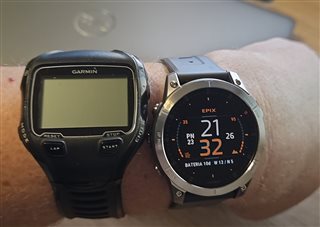

I'll try to explain it.
1. Until recently I used Foreruner 910XT. Results from 2 years ago refer to registration on this device.
2. I have been using EPIX 2 for several weeks.
Both are configured identically and I have an idea that there is nothing stopping me from taking them both to the swimming pool. It will be fun.
3. I described the operation of both devices, stating that after understanding what movement Foreruner recognizes correctly, I managed to achieve a measurement close to the actual result. Which means correctly detecting the style throughout the workout and most laps.
4. Now I use EPIC-2 and the old problems have come back - we can't get along.
c) Pool lap - is configured correctly. The length of the pool is 25meters, the touch screen is disabled.
d) Buttons - thank you for the tips, I haven't learned how to use the buttons yet, I use automatic modes. The buttons on the Epic-2 are not conveniently placed for me. I preferred Start/Stop and Lap on Foreruner. I will try.
a) Swimming style - Of course, you can always point out someone's mistakes. Garmin can't be wrong...
Or maybe instead of pointing out swimmers' mistakes, Garmin could implement machine learning algorithms and each watch could learn movements from its user? This is a programmatically trivial problem to solve...
b) Pool size...
"Długość basenu" means "pool size" ;-)
Fortunately, I no longer have a problem with slower swimmers ;-) Occasionally, I simply overtake some of them or wait until the distance between us is large enough that I won't have to slow down or change my style.
Either way, I'm going to have a lot of fun, let's see how the tests of the new and old models turn out. It'll be fun.
I will share the results.
May the force be with us ;-)
