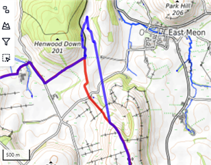

  • Maybe this was part of the reason. My tracklog was rock solid for 159 Km however it went for a wander in the wrong direction for a while. The red line is the actual course which is about 1.5Km. My watch was in Ultra GPS only mode as was testing for a longer race. I wonder if ignoring the 'GPS Only' and going on to 'All Systems' would have made it more accurate and less likely that this wander for 10 to 12 minutes would have happened. If so I would take accuracy over battery every time. When it uploaded to strava I got a 14 sec 1Km PB which made me search for this.
    So I don't know if my original blue triangle on save and this is related or if I actually had two significant issues with the watch on this run.
