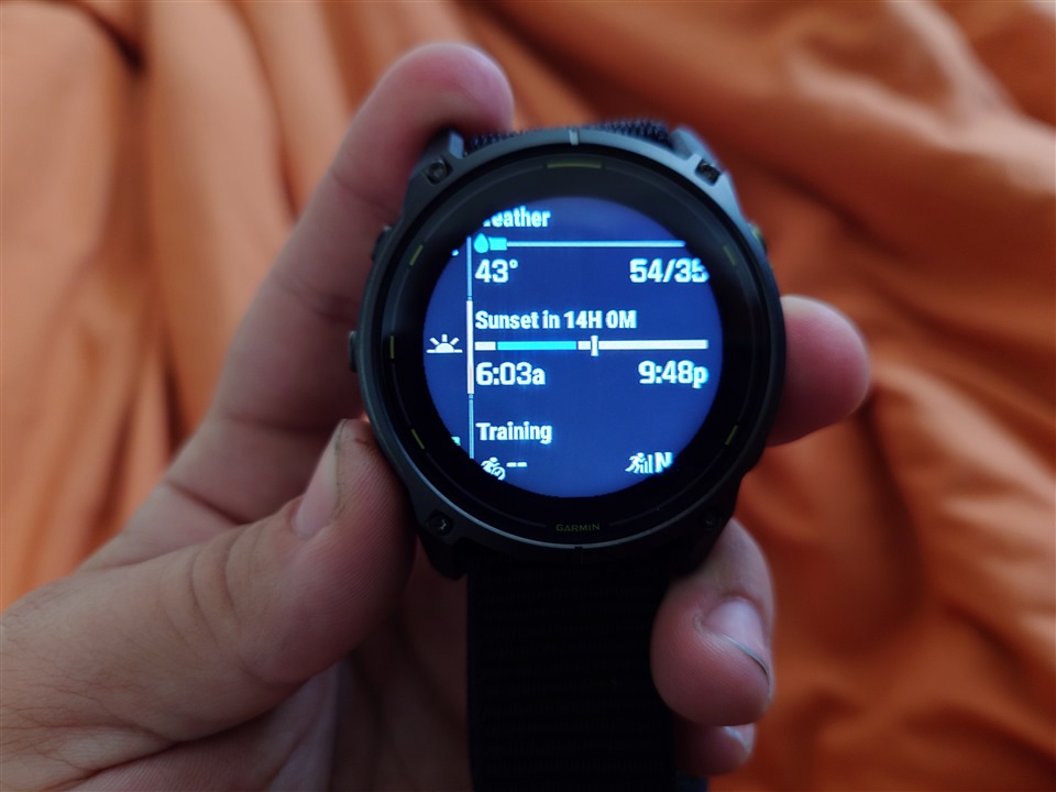

When scrolling the glance screen once you get to the training tab the whole device locks up and forces a reset.
It was working fine yesterday and now today its having this issue.
