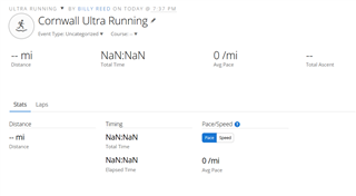

#1 - After the race I synced my watch to the mobile app but it didn't upload to Garmin Connect. I was really interested too view what had been a difficult race but as I was away for a long weekend I couldn't download the fit file until I got home to my laptop. When I got home I tried uploading it to Garmin Connect and it said it was already uploaded but no details (attached screen shot). I deleted it from Garmin Connect and tried uploading the fit file again manually several times but Garmin Connect just says 'An error occurred with your upload. Please try again'. The file size copied from the watch is 8.1 Mb. I am able to view the fit file in seconds on sites like GPXSee, Fit File Viewer and uploaded it to Strava with no problem but I can't upload it to Garmin Connect. I will try and attach the fit file to this post.
