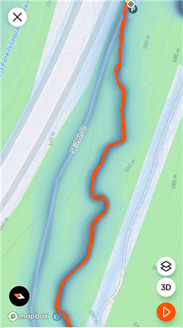

The two screenshots above are from two trail runs on exactly the same trail a few days apart - the first one with Fenix 7X, the second one - Enduro 3.
What you see is the offset to left side relative to the direction of run. My estimate is that the offset is about 5 meters (15 feet) each way, so 10 meters between the out and back tracks. The same effect can be observed throughout the entire run, but here it is the most pronounced.
I remember Fenix 6X having the same issue. Fenix 6 has an older Sony GNSS chipset. Enduro 3 has a newer Sony chipset, so that is common. Fenix 7 has a Mediatek Arioha GNSS chipset.
Has anyone observed a similar issue? Consistent 5 meter offset is pretty bad for a watch released in 2024 if you ask me. It is supposed to be within 2-3 meters 95% of the time as you see on the track produced by Fenix 7X.

    Have you set 1 second data recording?
    I don't think recording rate should matter at all. GPS chipset operates with the same frequency (once per second) regardless of whether it is smart recording or once per second recording. Smart recording affects only recording of the data to the storage as the name implies.

    It probably depends on speed. When I had Fenix 6X, the offset described above happened only when I ran. As soon as I stopped the position would quickly correct. Then as I resumed running, the position would offset again. Perhaps when you move slowly on a mountain terrain, the issue isn't noticeable. Also, problem seem to be more prevalent when there are reflections of GPS signal from trees or buildings.
