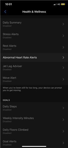

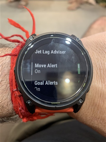

Hi there,
Enduro 3, 12.35
On Garmin Connect, Notifications and Alerts - Health and Wellness are disabled.
However, on the watch I can make changes.
Could someone please help me how to fix it?

Thanks for answering post. I fixed the problem signing off from Garmin Connect on my phone and signing in again. For some reason, there was some glitch that lost connection to that specific session. After sign-off and sign-in, all is back to normal.
