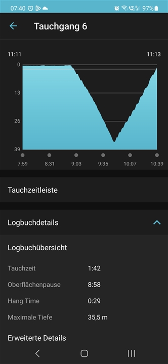

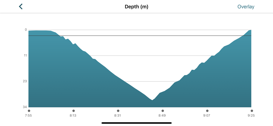

    This is unrelated to this problem, but the only other issue I have with the app is the dive timeline (graph). Instead of starting at "time zero" the individual dive timelines start with the beginning of the surface interval for that dive (or end of the last dive). To me, this is useless. It makes more sense to start at the initiation of the descent of each dive so that you can see where you were at any point during the dive without having to do math. That is, unless there is a setting to change this that I haven't found
  • Which app and version are you using? For me (latest version Garmin dive on Android) it shows both the time of day and the time passed including surface interval. See screenshot. On the other hand, I don't have the overlay option shown in the screenshot above by
    Also I can't see any way how to get a larger graph in widescreen ... Everything works different than in the main Garmin connect app.
