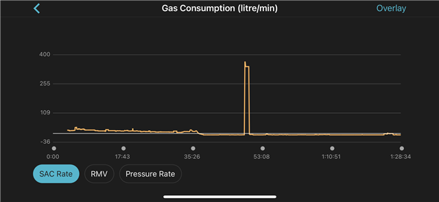

For me, the main reason to buy T1, was the ability to analyze the gas consumption after the dive. It appeared useless for Multi-Gas diving; the main issue is the software.
Here is my first dive with T1 (Trimix 20/20 + EAN53 + EAN80): connect.garmin.com/.../9860816129
Here are a few issues:
1. Gas Switches. It is possible to see the gas switches only inside the divelog in the watch itself. Why isn't this information shown in the web interface and even not in the application?
2. It should stop calculating average levels of SAC/RVM if I'm already switched to another tank and changed the gas inside mk2i. Or it should be another metric like "SAC/RVM while using the tank"
3. As you can see from the link above and attached screenshot, I turned off one of my primary tanks (while on EAN53) and released the pressure at 48:08. This led to a huge peak on the consumption graph, which I did not expect there.
In conclusion, it is almost impossible to calculate real gas consumption with the implementation of the current tools. I believe you have all the data to make it more clear from a statistical point of view.
Could you please fix it or provide a more flexible way to analyze the dive, considering gas switches and average consumption between the chosen timestamps?
