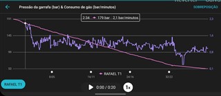

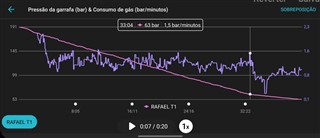

As we can see on the two images below:
Dive time 2:34 -> 179 bar
Dive time 33:04 -> 63 bar
The mean of the gas consumption should be about: 3.8 bar/min
But, based on Garmin Dive App Log and Mk2i (during dive) the mean is around: 1.3 bar/min.
Please, fix it!
