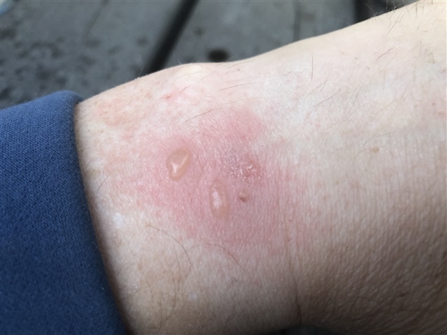

D2 x10 sensors burning wrist
My watch”s green and red sensor lights are stuck on full brightness and won’t turn off.
I realised this when I got a low battery alert this afternoon, when I only charged it this morning.
The skin on my wrist now has 2nd degree burns, it is blistered under the sensor areas. The watch itself became very hot.
There are many other reports of garmin sensors burning peoples skin. Recall the product, it is dangerous!!

    it is definitely the sensors, as that is the exact area of my burns, and that is where the watch is getting extremely hot.

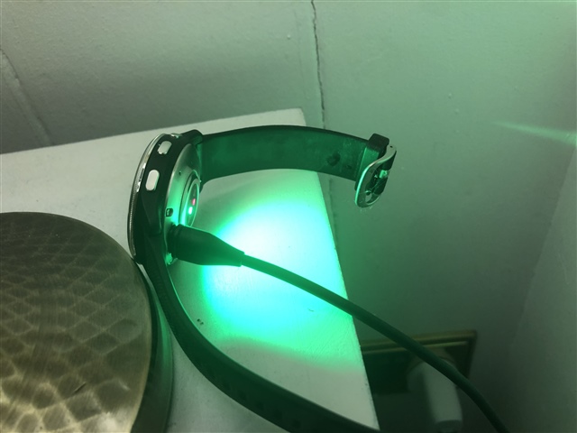

    I have just put the watch on charge and both sensor lights, red and green, illuminate at full brightness and don’t turn off. The back of the watch, right next to the sensors then becomes extremely hot to touch. Hot enough to blister my skin, I will attach photos when I get back to my home computer.

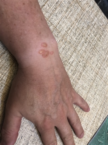

  • I can assure you, with absolute certainty, that this was NOT the result of a skin rash.
    The watch itself, specifically the area of the light sensors became too hot to touch.
    This was a heat burn caused by the high temperature of the light sensors.

    So yes, my D2 is faulty to be producing sufficient heat to blister the skin.  My current observation is that the heat is coming from the area of the light sensors. The device won’t charge now, and when I plug it in, it goes through its start boot up, both sensor lights illuminate, and then it shuts itself down.
    The Garmin support team are being very helpful, they are considering my problem, and I’ll let you know what they think.
  • sensor lights come on during charging, and won’t turn off despite ‘resets’.

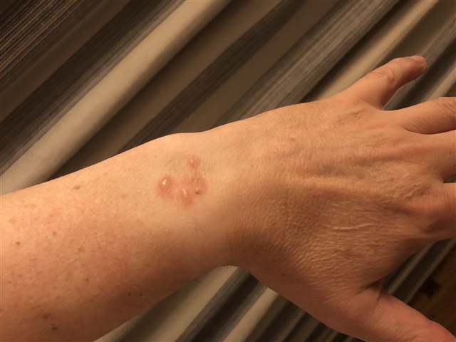

  • Immediately after taking off the D2.It was a slow burn!  I don’t think I noticed any discomfort until about 10 mins into the cooking process.
