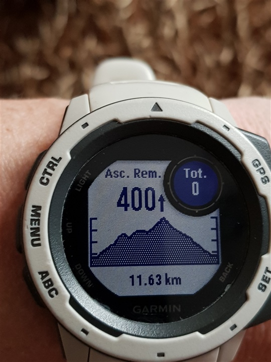

  • This is a data screen I have on the watch when I am navigating a saved course while trail running. Is this what you are looking for?
  • Thanks for the reply. This is good to know about and sort of what I'm looking for, except I'm after something that can be set on the fly, perhaps multiple times during a trip, without navigating a predetermined course. I'll give a couple examples of how I used the feature on my Casio.
