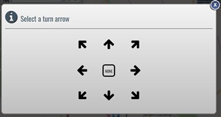

  • There are only 9 "Turn Arrow"s at Plotaroute and several "Symbol"'s
    Only the the "Turn Arrow"´s follow ANTSDK format/type. Symbols are not...
    Also if you choose a Symbol Plotaroute is changing course_point's original names...
    See a sample table bellow:
    First line: type 6 is for LEFT and "Head South" is the modified course_point' name done by Plotaroute...
    Second Line: type 7 is for right so is correct . I did not choose any symbol therefore the name was not changed. Which is what should happen IMHO.

    Here are my findings testing plotaroute after your comments:
    1- Use Symbol or Turn Arrow, not both, and make sure to set the other to "i" or to "none" respectively.
    2- No matter if you fill both "Directions/Notes" or "Label" Plotaroute wiil cut it somehow...
    3- Plotaroute will try automatically to set a Turn Arrow not always right so you need to double check it and set to none when you use a Symbol.
    4 - Follow bellow an schedule to use it. Despite not having them all  and this thing of use arrow or symbol it is good start.

  • Great compiled table of course points.
    Comments on your points.
    1. Never have had any problem if I select an arrow OR symbol. If I select both I've had some unpredictable results.
    2. I've not used label, but I thought that was not used in fit file at all. Tested the length of course point description that my watch (5x) could handle at the time and it was 15 char. Plotaroute give me that, but I didn't test max in plotaroute.
    3. Yes. I always need to go through the direction list and double check that the auto generated is correct. My conclusion is that the auto generated text is a lot more correct. If I'm in a hurry creating the route, I just check/change the turn symbols to the same as the direction text. Hopefully there are some improvements on the way.
    4. As said, great summary of all available types.
