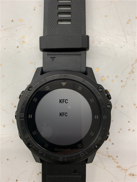

Also, I reported this as a problem well over a year ago with the Fenix 5, Tactix Charlie, Fenix 5+ series watches. If you chose a POI and you scroll down to “Review”, it’s supposed give the company name and information. On the previously mentioned models, it does not:
On the Descent Mk1, it does:
Now, if you install the City Navigator Map (USA) on the previously mentioned models, it works. I’ve done A LOT of testing and this is what I’ve determined to be the issue...Maps.
