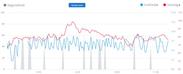

No reliable means that there is one data point for cadence and then 10x none, while there are data points for speed and HR. Then 1 more datapoint and then some other amount of missing datapoints again. See graph below. Cadence in grey, speed in blue and HR in red. This is about 7 minutes of data.
Hmmm, strange. One more idea: Garmin has a hand option in the setup. You need to set the side on which the device 'lives'. Check that yours is left. I know, this is reaching, but we're getting desperate here. Any chance the cadence peaks are your sprints? The values you have a way too high for regular paddling which should be around 30 strokes per minute not 60. Finally, cadence registers up-and-down motion. Depending on how you paddle, you may be doing mostly back-and-forth motion with very little gravity change. That may be a problem too. Try to exaggerate up-and-down aspect of your stroke and see if that makes a difference. But I suspect it's the app trying to do something fancy or just not having the algorithms set up appropriately. Personally, I use DozenPaddle data field and Row,Sup,Kayak activity by Fbbbrown. Both work flawlessly. If Garmin SUP native activity works, you may want to give these two a try.

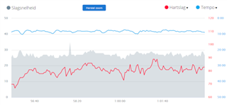

Finally, I used the build in SUP app and now I get better results. Below screen shot of part of last night data (cadence in grey, HR in red). Thanks for your help Karovaldas, I will try out your suggestions for datafield/apps.
Glad to see you got it to work.
