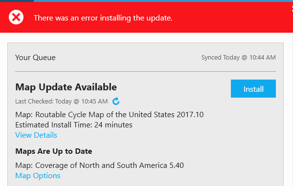

I'm on the latest beta for my 5x and I noticed today when I tried to sync the watch via Garmin Express that a map update is available for the cycling map. This fails at the "preparing device" phase. I have almost 6GB of free space, so I don't think that is the issue as the file size of the update is listed a 2.13GB.
I've sent the express log to Garmin but there isn't anything really obvious there
Basically there is a line that says
"System.AggregateException: A Task's exception(s) were not observed either by Waiting on the Task or accessing its Exception property. As a result, the unobserved exception was rethrown by the finalizer thread. ---> System.ServiceModel.FaultException: The creator of this fault did not specify a Reason."
which appears to be another way of saying "this went poorly."
Is anyone else seeing this error?
ciq.forums.garmin.com/.../1251565.jpg

  • I got the new 2017.10 cycle map, but it won't install for me either. Just updated the watch to v6.0 too.

  • And looking in the CoreService.log, I'm getting the same error which was reported at the start of this thread:
    2017-09-22 16:03:50.4834 | 20 | W | Exception in operation Garmin.Omt.Service.Operation.Map.UpdateMapOperation.
    Garmin.Omt.Service.Operation.Map.InvalidMapInstallException: Could not determine where to install the map.
    at Garmin.Omt.Service.Operation.Map.Projector.ProjectMap(IDeviceMapUpdate update, IDetailedDevice device, IDeviceIO deviceIO, IMapContent content, IEnumerable`1 softwareReinstalls)
    at Garmin.Omt.Service.Operation.Map.Projector.<>c__DisplayClass1_0.<ProjectMapAsync>b__0()
    at System.Threading.Tasks.Task`1.InnerInvoke()
    at System.Threading.Tasks.Task.Execute()
    --- End of stack trace from previous location where exception was thrown ---
