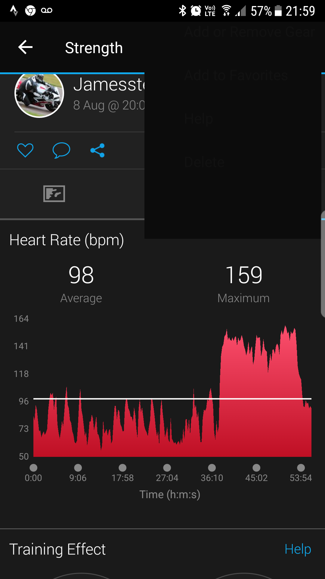

  • Used my 5x and garmin hrm at crossfit earlier. This was the trace. Early part was warm up and strength part. The latter part was the work out and the hr was obviously much higher.
    ciq.forums.garmin.com/.../1239295.png
