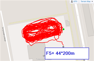

Especially on small circles like 200m track. Look on the image! Actually, it is the worst image I ever seen on Strava! Compare my new 5 plus (on the top) and iPhone (bottom). Even cheapest Android costs 10x less than Fenix has much better GPS performance. Even my old Vivocative HR had MUCH better tracks. Now I shame to publish my runs from my 700 euro device, they look just terrible. I can't understand how Garmin was able to make a product with SO bad performance of its MAJOR feature.
Fenix 5 Plus vs. iPhone X GPS Performance

  • So finally I've installed 2.51 beta GPS update. Tracks looks better now in some extent; meaning not so ugly as used to be but still not so realistic as a track from smartphone or Polar. On other hand, on the 200m intervals it seems F5+ correctly counts laps. I also compared a plot after update from the latest parkrun with the plot from M400. Definitely, F5+ looks better now (note M400 out of the track places marked by red arrows). So 2.51 is not HUGE step forward but considerable; now my F5+ is not on sale anymore Slight smile

  • OMG Joel, it is even worse than my example. That is really odd - as soon as I know, reflections handling was a part of GPS devices for the very long time. Sophisticated devices as high-end Garmins should be able to fight with them. Unfortunately I can't share my experience for that conditions - I never run near tall structures. My "reference" 200m track has perfectly open sky with no tall buildings nearby.
  • Thank you Alan. Do you mean this part? It looks good for me, doesn't for you? Two laps however probably is not so representative. Note that my track has proper "shape" overall. The problem comes with counts - shape becomes a ball as wrong laps accumulate.
