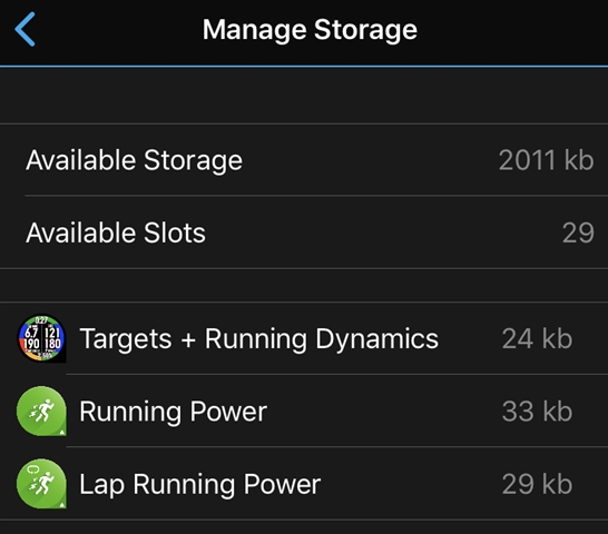

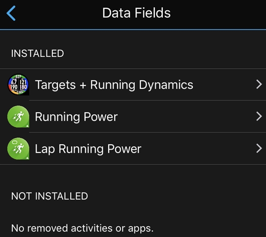

  • Is this the data field you are using to show power?
    https://apps.garmin.com/en-CA/apps/741afa11-0250-48e2-86b5-14bd47e29391#0
    If yes, congratulations. You may be the very first person to actually use that field.
    I can see in the description that it needs permission to write information to the .fit file, so it would seem that Garmin's intention is that power should be recorded.

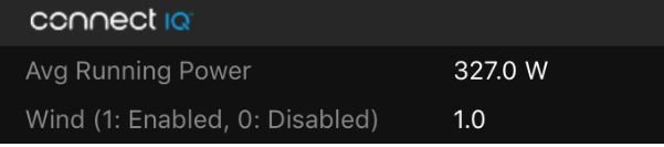

  • I use it, it works, and it writes power data to the fit-file. (using an RD-pod) I also forces the watch into 1 sec recording.
    I can't say anything about the quality of the power calculation though, as I have nothing to compare with..
