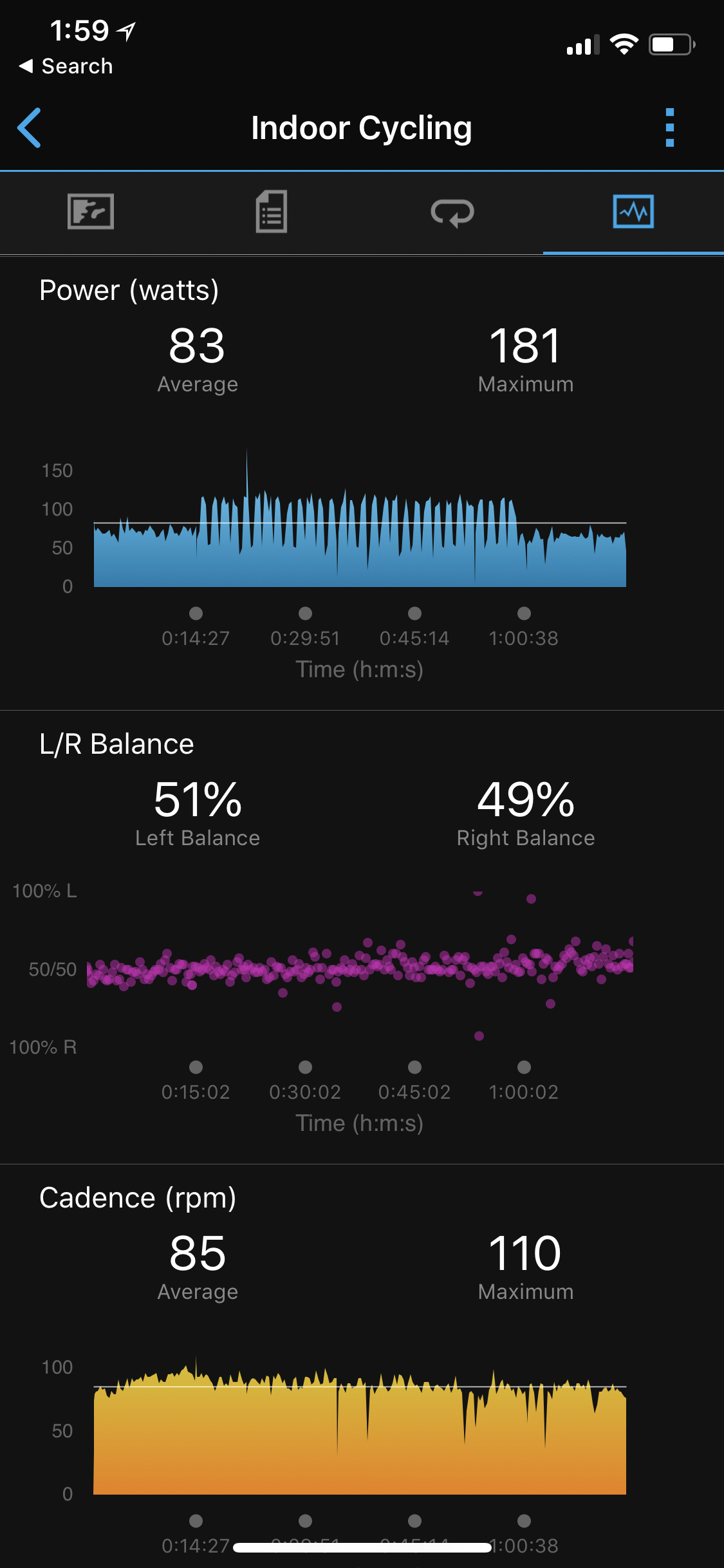

I did an indoor cycling session yesterday. I used my garmin edge 520 and the new Garmin Fenix 5S Plus.
Please have a look at data of the Fenix 5s Plus. Power and cadence have so many dropouts, while my edge 520 was much better. The end results are quite different.
I noticed the dropouts happening whenever I remove my hands from the handlebar. The power meter is Quarq Dfour and the connection is ANT+.
Please advice if this is a watch connectivity problem?
ciq.forums.garmin.com/.../1391062.png ciq.forums.garmin.com/.../1391063.png

    Updated the Quarq Dfour and did a 45 min cycling recovery workout. The dropouts are still there on F5S+, while Edge 520 is totally fine. This time it includes dropouts in HR as well. All in ANT+.
