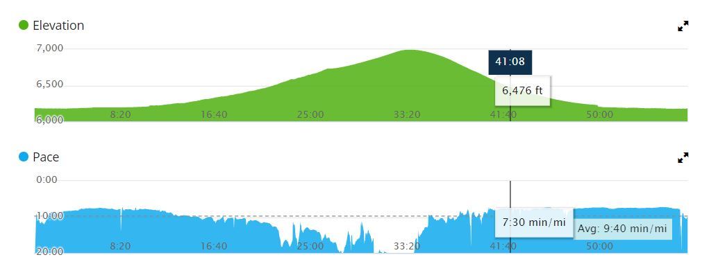

Hey Group, Coming late to this thread here. I have had the Fenix 5 plus for a couple of weeks now and it looks like 4.0 might have fixed this issue. I am curious with those who don't have the 4.0 update yet, have you compared the elevation charts when the corrections are ENABLED vs. DISABLED in garmin connect. Just wondering if that option for now improves the accuracy of the activity. I know this doesn't help during the activity but at least the record is accurate??
