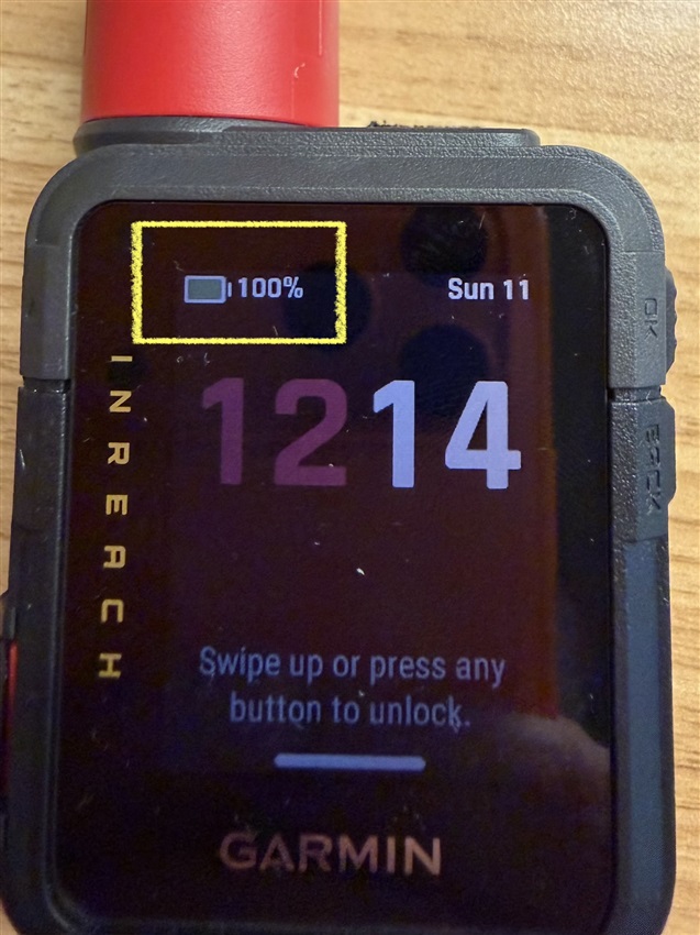

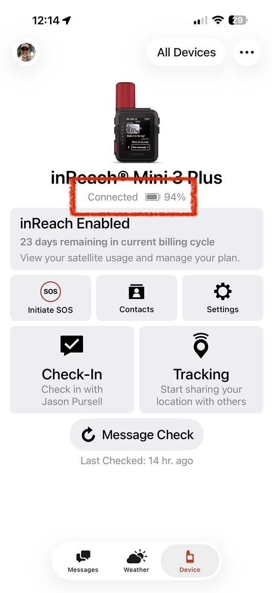

  7. Now open the Garmin Messenger app on the phone and view the InReach status page.
Observed: The battery percentage is lower in the Messenger app than it is on the InReach device. In my case the Messenger app read 94% while the InReach read 100%.
Expected: Battery level in the Messenger app is the same as on the InReach device.

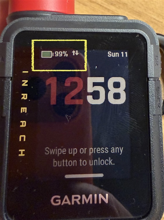

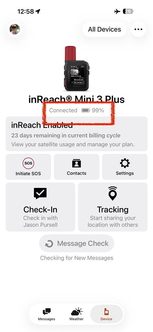

Workaround/Mitigation:
Simply waiting for the InReach battery to naturally drain one percentage point on the device causes the app to "resync" and display the correct value again. In the example I used for the steps to reproduce both Messenger and the InReach would now show 99%.
NOTE: You can speed up this workaround in a couple of ways. 1. by setting your phone to airplane mode with no wifi and checking for new messages on the InReach while inside a building (to force faster battery drain). Or  2. you can close the Messenger app so that the InReach will be forced to use sattelite. After the InReach reaches 99%, reopen the app and it will show 99% too.
This is really just a cosmetic issue only. It is some kind of initialization/optimization bug where the messenger app is not setting the battery level to the new value after the InReach has been recharged while the app was closed. One interesting thing is that the Messenger app chose to display 94%, not 90% that it showed in step 3 of the Steps to Reproduce. Maybe that's a clue as to what or where the bug is?
These two images show the results after Steps to Reproduce:
These two images are after the "workaround" where InReach device's battery drained from 100% to 99%. Now Messenger shows correct value. I actually watched Messenger update in real time:
