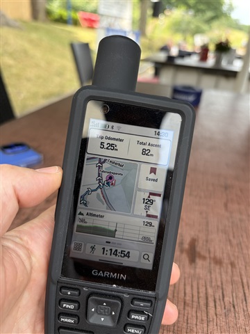

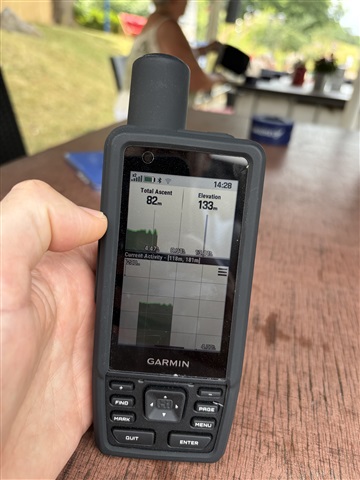

Hi,
I installed the latest update and did a quick test and it happened again. I planned a route and navigated it. In the beginning, the graph was fine, showing the part I already did and the upcoming part in blue. But after a while, the blue part just disappeared. When opening the altimeter view, the detail view of the upcoming part also has not been displayed. When I moved the selection in the overview part though, it reappeared. Anyways, when switching back to navigation view, the preview was still missing. After going on for a while, it reappeared.
For me it looks like there is something in the to-come altitude data which the widget cannot display. Hence, when I moved past that point, the widget worked normal again. But this is just a theory.
I documented it by photos and videos which I uploaded to the URL you posted. Also, I uploaded the Garmin folder, but I deleted the large files.
I hope the information I provided helps investigating and solving this issue. Let me know if you require more data.
