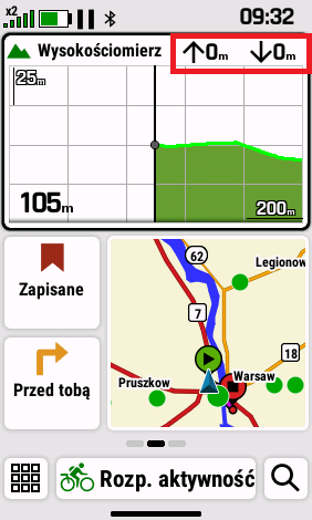

  • Hi, I added the Altimeter widget to my glance view. In the top right corner, there are two fields: an up arrow and a down arrow, both showing 0.
    These values never change, even when I'm moving or using navigation. They remain at 0 regardless of whether I'm recording an activity or just wearing the watch.
    Is this a bug or am I missing something? Should these fields track daily elevation gain, or do they only work during a timed activity?

  • I tested this today during a bike trip, and it seems like a clear bug.
    I prepared a course on my device with approximately 100 meters of ascent and 100 meters of descent. Unfortunately, the data fields on the Altimeter widget are "dead" and completely useless.
    Regardless of the following conditions, the fields constantly show a value of 0:
    Whether an activity is currently being recorded or not.
    Whether I am actively navigating or not.
    Whether I am following a track (breadcrumb trail) or using "Direct To" (straight line) navigation.

  • Can confirm that the large altimeter glance doesn't show total ascent and total descent, both values stay at 0. Data field glances for ascent and descent do show recorded values.
