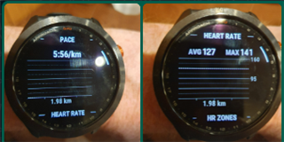

Has there been any fix? I have the latest update and I still do not see heart rate/speed graph after I complete an activity or if I go back to Last Activity. It shows the max and avg numbers but no lines in the graph

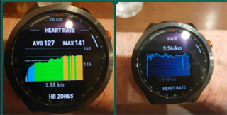

Here are my findings and a way to reproduce the bug:
- turning the watch power OFF/ON give you access to heart/pace graph for the LAST activity:
GRAPH ON
- If you try to look at PREVIOUS activities, there's no graph
- The graph disappear as well from the LAST activity (unless to switch the watch OFF/ON again)
GRAPH OFF
Was not able to get the heart/pace graph today, even when switching ON/OFF.
