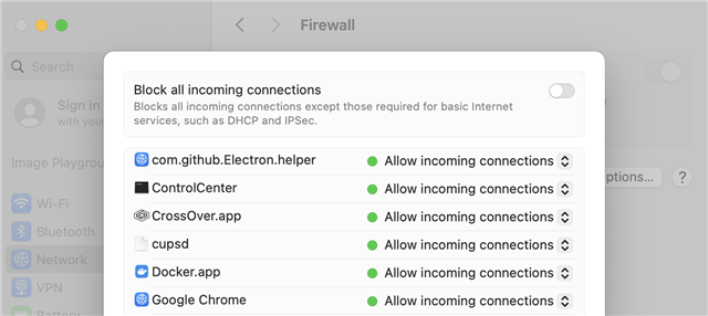

    I thought I could solve this by disabling firewall OR by whitelisting CrossOver, but no luck.
    System Settings -> Network -> Firewall
    Let me know if anybody has more info on that specific error
