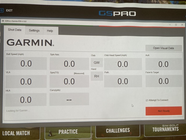

    still get stuck on looking for Garmin. One thing I’ll note is that when the Connector window opens (v1.8.8 ) there are boxes below path and face to target that initially appear and then disappear.
    Previously, the only way I’ve been able to get it to change from Looking for Garmin to Attempting to connect is by exiting R50 Connect, turning off R50 wifi and then relaunching hotspot. But then it’ll stay connected 2-3 shots before disconnecting.
    does your connector window v1.8.8 look the same?
