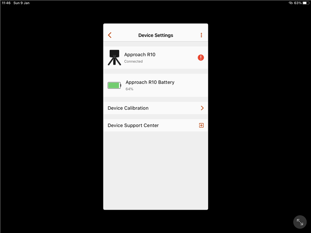

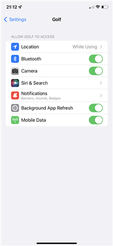

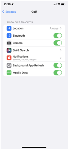

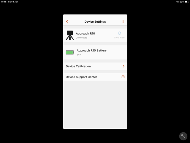

    I believe I have the R10 connected to my phone, it shows the green flashing light and when I play a shot it goes solid green however it doesn't show a shot in my phone. I have also tried my ipad and have exactly the same problem. See pictures below. It feels like the software wants to connect to Garmin and it can't which then stops everything else.
    The only thing that doesn't feel right is that it consistently is trying to 'sync' every once in a while it disconnects, reconnects and then keeps trying to sync. The app doesn't like it when I turn all data off, I had assumed the range mode could be used offline but this doesn't appear to be true. everything is set up to be on in the app
