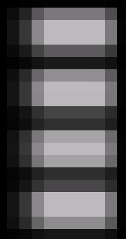

  • I think I was right
    there was black, you can see it while zoom it
