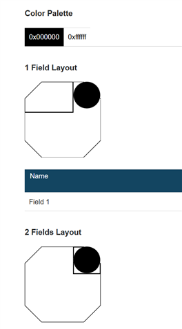

I have raised a question on the Discussion forum regarding the area available for drawing a data field on the Instinct 2 family. The full thread is available here: https://forums.garmin.com/developer/connect-iq/f/discussion/401206/how-to-handle-the-instinct-2-screen/1885985#1885985
Basically, I ran a test in order to get the screen dimensions of the I2 base model and compared the results with the reference page. While the reference page says its dimensions are 176 x 176, the dc.getWidth and dc.getHeight return 112 x 71. Also, on the original thread, it was noted that the onLayout seems to be called twice when only one was expected.

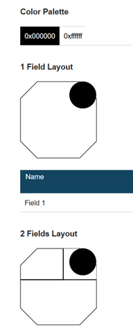

The same code on I3, for example, works as expected:

  • Also, the device reference guide for Instinct 2 shows the same thing as the simulator, for 1-field and 2-field layouts.
    https://developer.garmin.com/connect-iq/reference-guides/devices-reference/#instinct%C2%AE2solardualpowerd%C4%93zledition
    i.e.
    - 1-field layout exists (according to the doc), and is just a small field in the upper left hand corner
    - 2-field layout is: 1 field with the entire screen, and 1 field with the subscreen. (Note that this is not 100% clear from the diagram)
    Similarly, the behavior of instinct3solar45mm in the sim for 1 and 2-field layouts matches the doc:
    i.e.
    - 1 field layout is the whole screen
    - 2 field layout is small field in upper left hand corner, and wide field in bottom half, both excluding the subscreen. Again this is not super clear from the diagram.

    There is really no 1 field layout. You can have 2 fields or more.  The subscreen is a field, and the screen except the subscreen is a field
    I see, that explains the following output with my test code, when I select 2 fields in the sim for instinct2:
    onLayout
    dc.height = 176
    dc.width = 176
    onLayout
    dc.height = 62
    dc.width = 62
