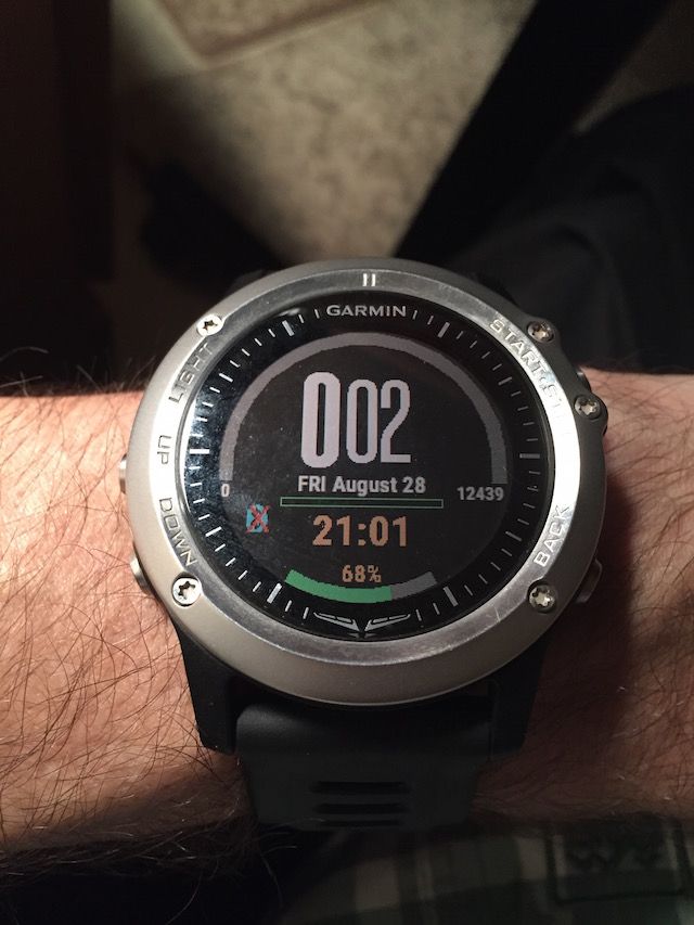

Watchface: SoF - UTC
Just submitted a variant of my Steps on Face watchface with the original name SoF - UTC. There were requests to also display UTC on the main face.
Hope people enjoy.

  • Major Code Rewrite
    Version 2.0
    Major code rewrite - added support for multiple devices - F3, D2, Epix, Forerunner and Vivoactive
    For the square watches the battery percentage is shown in the upper left corner - no bar
    Please let me know if the language translations are not correct - google is not infallible
    I only have the Fenix 3 to test with, so please if you have another platform and have problems, let me know and I can work on them.
    I have also added support for French, German and Spanish. I can add other languages easily but will need to know how the date is displayed.
    Please provide any feedback.
    Thanks,
    Paul
