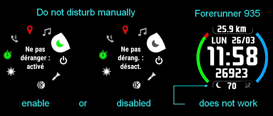

  • Hello Gurjon
    After the last update I lost a function that I liked a lot.
    I can not disable / enable do not disturb manually.
    The icon to change from a bell bar to a moon, it's not a problem ..
    My sleep hours are programmed in my profile, but often I will run at night and
    I could deactivate do not disturb. It does not work anymore ... Thank you
    P.S. I chose this skin for sleep mode that worked very well ...
    community.garmin.com/.../1327195.jpg
