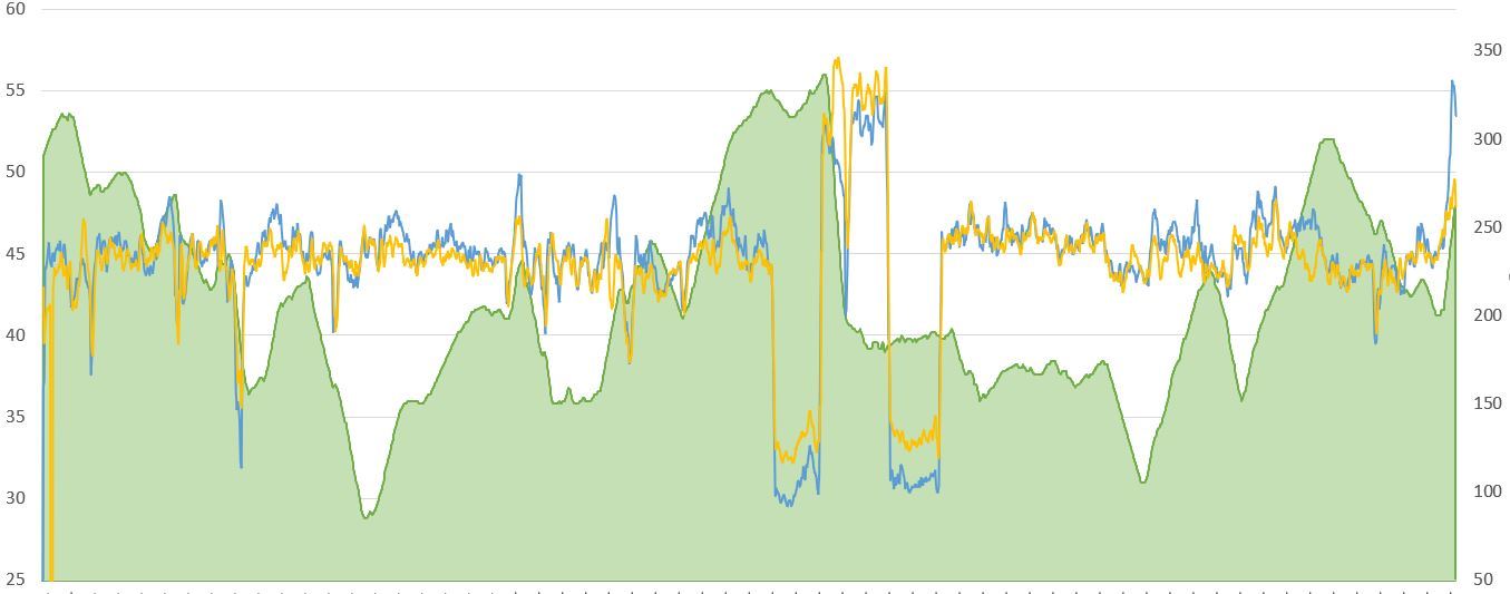

    The recorded power from Stryd is much more refined though, probably their altimeter is also more accurate. But on the go both are off from RPE at times, mostly because of the lag there is to grade calculation. Also when using GPS there is also the speed lag. Still it was surprising that using just GPS as speed source the numbers weren't more off. I had a seemingly good GPS day as the distance was spot on with my calibrated Stryd, and admittedly the GPS is more accurate / stable on F5+ than it was on F5.

    Well seems the Stryd altimeter is much more refined. Here's the same formula running on Stryd elevation from offline data. This is the same run data as in the first picture, a lot less spikey actually:

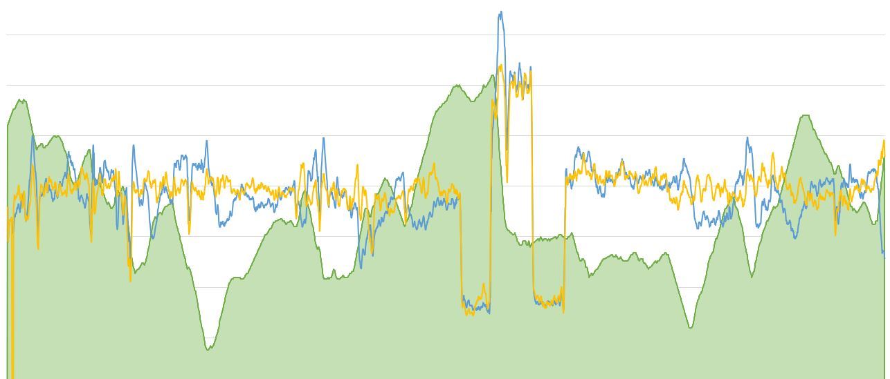

    Here's what simply GAP vs Normal Pace would look like (this one's the most describing actually), I used Stryd data for elevation again to get a cleaner comparison. Too bad the altimeter is so bad on a top of the line watch like the F5+. Just shows how Garmin puts poor quality components in these watches to make big profit.

    My favorite part is the 1 min test downhill, the sudden drop in graph is caused because of a 90deg turn after a snowy hill so I had to slow down to not fall, but otherwise I went as fast as I could, with correction the speed stays nice and level. :)
    Also notice in the previous graph how much Stryd drops in this same downhill section even though I was starting with fresh legs after rest so here I actually think Strava GAP is closer to truth.
