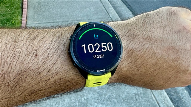

  • Hi Sergey, is it possible to have a function where you will be prompted once you have reached your goal?
  • Hi! Garmin watches have it under Settings — Health and Wellness — Goal Alerts. It looks like this:
    For the custom goals configured in this application, it's not feasible to add such alerts.
