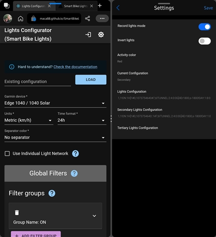

  • Hi maca, the separator colour from the configuration seems to get overwritten by the ciq setting. Any tips on how to get it working?
  • Hi,
    I tried with Edge 1040 and it works for me. Which Garmin device do you have?
  • Same..! What colour have you set in CIQ?
  • In the Light Configurator I choose green and the separator is now always green no matter what color I select for "Activity color" app-setting (currently set to blue). Can you share your configuration so that I can try it out?
  • Sure - I'll be back in an hour or two to try again & share my settings with you.
  • Hey maca,
    Initially after app update. Load config into Configurator and separator defaults to activity colour. Meanwhile CIQ was set to red. Datascreen shows red.
    Next, changed Configurator to no separator. Pasted the new config into secondary and set CIQ to use secondary. Datascreen shows no line GrinOk hand
    Then, tried changing CIQ to green. Same config. Still no separator.
    To see if it just needed a 'reset', I switch back to my primary config. CIQ had green from previous step. Now separator is green.
    And lastly here's the config I'm trying to make work:
    1,1!ON:1H]1#0,1073754640::1#7,6!TUNNEL:2:4:0:0G[4Er1800,s-1800!DAY:1:8:0:0Er1800,s-1800!LOBATT:1:4:0:0B]3!SSONIC:1:2:0:0C]9.72222!CRUISN:1:3:0:0C]5.55556!:1:4:0:0D=1#0,73535488::1#8,5!EBRAKE:1:4:1:0A[-10!NCAR:3:6:0:0B[4Es-1800,r1800I]-1]0!NIGHT:2:5:0:0B[4Es-1800,r1800!DCAR:1:7:0:0I]-1]0!:1:0:0:0D=1#5,5:HL 1800:0!1,:-1!1,High:2!1,Medium:3!1,Low:4!1,Day Flash:8#5,5:Varia 515:0!1,:-1!1,Solid:4!1,Peloton:5!1,Day Flash:7!1,Night Flash:6#0::#1:1#123!:123!#0#B3843#7#3#0#0
  • Hi maca,
    thank you very much for you answer and explanation.
    I will change the value in my configuration as you suggested.
  • APangers,
    The behavior that you are seeing is exactly how it was designed to work. Because your primary configuration uses "Activity color" for the "Separator color", it will use the color set in the "Activity color" app setting. So if you don't want the "Activity color" app setting to dictating what color will be used for your primary configuration, just change it to "No separator" (as you did in the second step for the secondary config) or any other color. Does this solve the issue or I misunderstood your message?
  • Understood. I thought activity colour means it will change to whatever my profile (mtb, road etc) was set to.
    All good - I will just use no separator Slight smile
  • Unfortunately there is no API that provides the color of the current activity, that is why the "Activity color" app settings was added.
