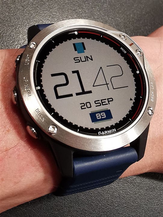

  • Played around a bit to make something that fits the Quatix. Banner on top is blue, but turns red when there are pending notifications. Heart rate at the bottom. Otherwise quite similar to the default face, which I'm very fond of.
    Code:
    01ZC5225111WDPO10180B0Vx2008040Vx50091200001X6WY020P121N11X6Vx036813N713XD811X6Xz03X7817Y6Vh0X6VYVlVW70W10X6VYVvO1X6S03Ve357010X6YjVWO70VW0X6YfKVWWv0Vw0X6YfKVW
