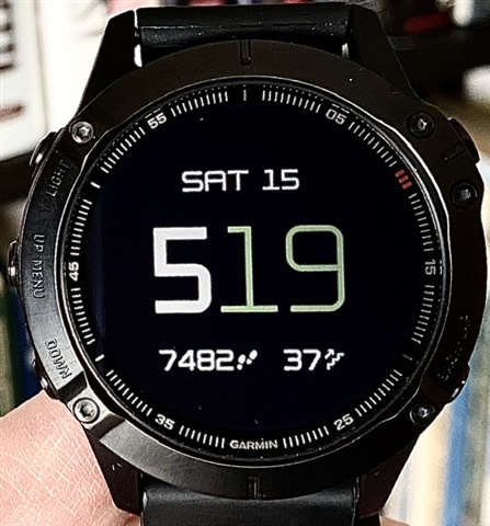

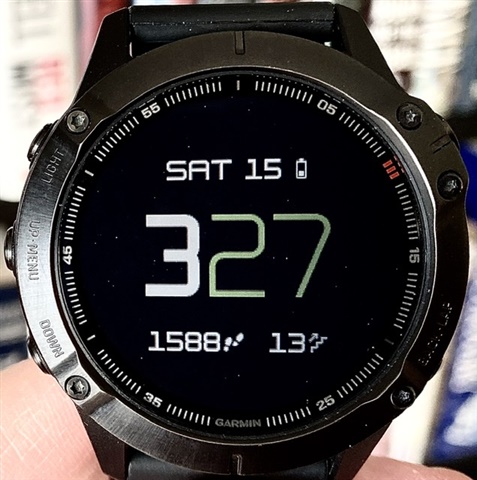

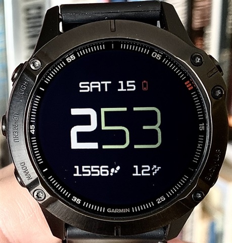

    Best watch face/app ever! After a lot of experimenting I think I found my perfect everyday M2 face. In addition to what you see in the pics, a simple thin white ring will start to appear around the face as the move meter starts signaling.
    Code:
    01ZC2525111WDPO1011X6WY020Q121OQ1X6Y703X7713N713571ZBN71YvN71YwH01YwVX05ZCH0VdZCVX0Vd1X6Vo03VV714L013N713N713VX714N018NB0Vx100
    Sate = Battery Full (no battery icon):
    State = Battery Medium (battery icon w/ % fill):
    State = Battery Low (red battery icon w/ % fill):
