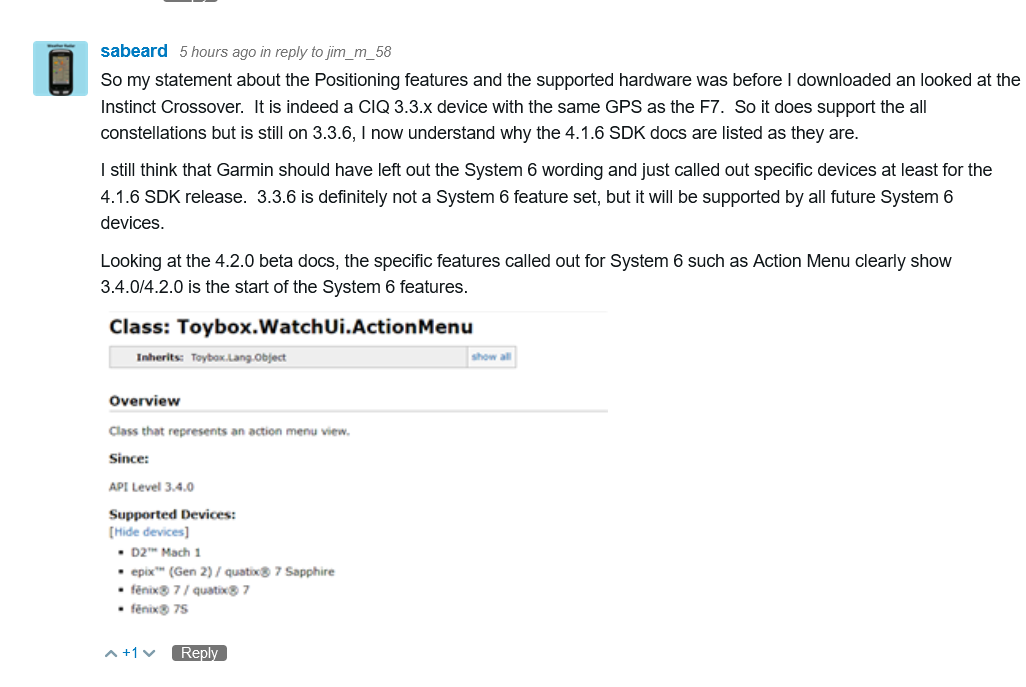

  • As far as I understood from DCRainmaker https://www.youtube.com/watch?v=o_g0rJ51i7A&ab_channel=DCRainmaker Instinct Crossover doesn't have multi-band. It has "all systems" but not multi-band. (look at 11:20)
    I don't think the new enablePositionLocations configuration docs are wrong at all, though, just a little misleading.
    They do say that the new configuration in general is available for 3.3.6 but they pointed out that certain options are only for System 6 devices. Again to me this strongly suggests that 3.3.6 is not System 6.
  •  I think you are correct that the best option is to default to just GPS.  It may be best to just leave the :constellations setting out of your options so the system will default to GPS only.
    As far as the second option, that only became available with the new SDK released today, and there are no stable firmware for the F7 that has the 4.1.6 VM as those are still beta releases.  Since Beta is a release candidate, any of them could become the next stable.  In which case what you see right now would be what you get in the sable version.
  • I agree that a little more clarity would go a long way. Smile
  • Thank you! Yeah, that's what I have in binaries ready to push out, no mention of :constellations at all (will push out only if the bug actually makes it to Prod as it's a somewhat a loss of functionality for users)

  • I could be wrong but I've never seen any reference to a 3.4.0  Just 3.3.6
    I don't really see what that proves. Because you haven't seen 3.4.0 yet, it's never going to exist? Because 3.3.6 has an exciting new feature, it must be a new System level?

  • It could also be that only devices with 4.2.0 are "System 6".  Maybe just ignore the :"system X" and go buy the min API level for something
