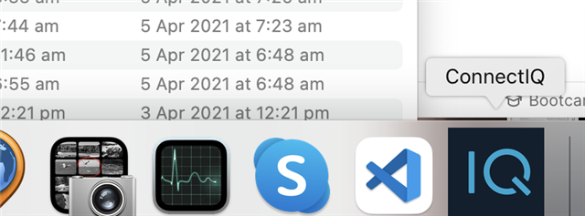

    Prior to installing the new SDK manager, the sim crashed and I had to start it from the command line,
    Now, when I revert to 3.1.9 the sim once again fails to start(the IQ icon appears in the apps strip
    But
    As before.
    But... When I try my fix, and start the sim from the command line, the sim crashes:

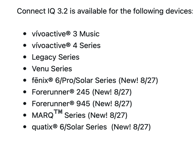

  • Since the whole new SDKManager and it's usage seems new to you, maybe this post when 3.2 was introduced may help:
    https://forums.garmin.com/developer/connect-iq/b/news-announcements/posts/connect-iq-3-2-now-available
  • I guess I skipped that because I'm supporting the Vivoactive HR and ist was not on the list
    Maybe I misinterpreted "Legacy Series"
  • Those are the devices that were getting 3.2 FW.  The 3.2 SDK would build for all devices.
    "Legacy" devices here are special versions of the va4/4s when it comes to CIQ.
    By the same logic, you would never have upgraded past Connect IQ SDK 2.4.x, since Vivoactive HR doesn't support anything higher than Connect IQ 2.4.1/2.4.2.
    But as Jim pointed out, newer SDKs still build for older devices.
