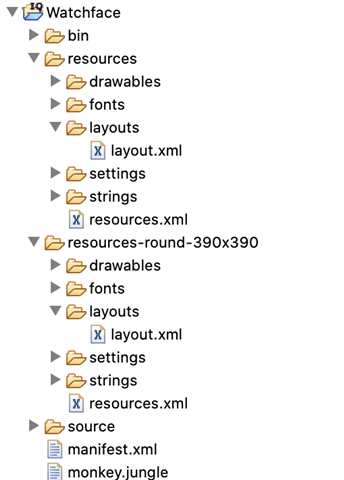

  • This is interesting. Here are the steps I took.
    #1. I moved all the resource folders away from the main file. I only kept the main resource folder and the 390 folder (picture below shows a snapshot).
    #2. I renamed WatchFace to WatchFace1 as you mentioned in the main resource folder. I kept WatchFace in the 390 folder.
    #3. I build, but did not see an error. However, I started to modify the main resource folder to " _WatchFace" and immediately saw an error. So I switched back to "WatchFace1".
