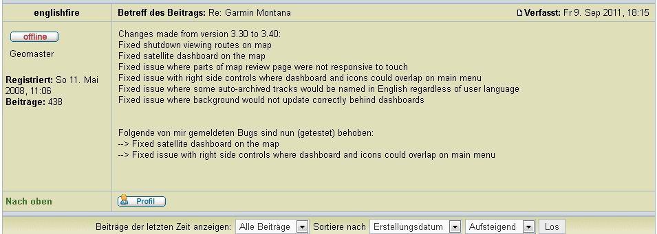

Changes made from version 3.30 to 3.40:
Fixed shutdown viewing routes on map
Fixed satellite dashboard on the map
Fixed issue where parts of map review page were not responsive to touch
Fixed issue with right side controls where dashboard and icons could overlap on main menu
Fixed issue where some auto-archived tracks would be named in English regardless of user language
Fixed issue where background would not update correctly behind dashboards
Folgende von mir gemeldeten Bugs sind nun (getestet) behoben:
--> Fixed satellite dashboard on the map
--> Fixed issue with right side controls where dashboard and icons could overlap on main menu
Den Rest habe ich noch nicht getestet.
Schaut gut aus!!
