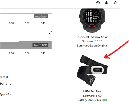

On running activities you can find on Garmin connect web or android an icon for hr pro. On open swim the icon for hr pro Is missing. could You fix It? Thanks I'm using 255 28.05 and hr-pro 8.80
As I wrote, if the image of the HRM is missing in the activity review, then it almost certainly means the strap was not connected (or the HR data download failed for some reason). If you export the activity…

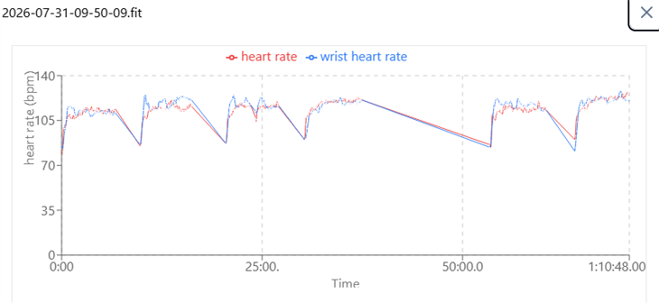

The FIT files of the swim activities are indeed odd. They do not list the HRM connected at all, claim that HR comes from the internal wrist sensor all the time, yet the final HR curve (that's the one you…
