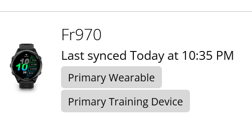

Hello,
Having an issue where personal records are not updating. I don't have any records pending acceptance and the watch is synced.
It's affecting all personal records.
