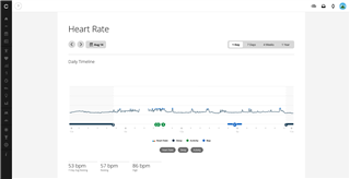

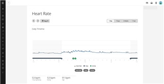

There are also other possibilities for the higher Active Calories on August 13, but you would have to post the screenshots of the following pages - that could help to see the difference in the HR during those days:
I retired my Vivoactive over a year ago after the battery died & dealt with my 6 year typo error for my account sometime before that, I believe. The factor you mention that pertains now to the Venu3 that might have influenced Active Calories would probably have been enabling activity auto-detection, but I did this only once about two weeks or so prior to that first calories glitch. Not sure then, why it might cause that lesser glitch a week later(?) Here are those two screens you refer to:
