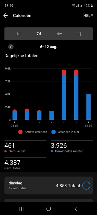

Since last Sunday my calorie count has been absurdly high. As in, literally waking up to already having burnt 3000 call! And finishing a fairly regular and chill Sunday with an easy strength workout at 9.393 Dizzy face If that were true I would be eating non-stop and not gain a gram.
My average rest cal was 1668 and suddenly jumped to 8.442 on Sunday. On Monday as well with just 30 min on a cross trainer, it says that I burned more than 1.000 calories. Even while wearing a chest heart rate monitor.
I have checked all of my personal data: weight, height, age resting and max heart rate. Nothing changed. My heart rate data is also not showing anything abnormal. Checked for updates, restarted the watch, but I can't figure it out.
Anyone have an idea?

  • Sorry for the late reply. I ended up contacting their support. That person also couldn't see anything abnormal that would have such an affect on the calories, after I had already updated any personal data I could find. They said to wait it out 1 more day and otherwise offered to have my watch sent out for a check, since the calorie count is really done in the watch itself.
    Miraculously it started going back to normal soon after. Before it happened I hadn't worn my watch outside of workouts much for a while. I started wearing it all day again after, in hopes of recalibrating it or something, and after 1 or 2 weeks it went back to normal.
    So can't give you a specific cure other than to update/resave all your personal data input (weight, max heart rate etc.), where it for a couple days and otherwise contact them (especially, if it's still within waranty time).
