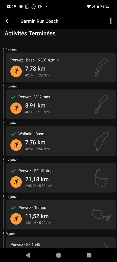

So... I tried to program a workout by myslef. I did that with a very simple one ("base training"). I used the exact same parameters that Garmin would use. But... Even if garmin recorded my workout (it appears in the workout history. See pictures attached. it's in french but pretty self explanatory I think). as you can see there is no "green check mark next to this workout.
And It did NOT recorded it as part of my training. It considered that I had a day off. Wich is clearly a problem for a self adaptating program. This workout was a small one. But I wanted to do the same with an interval training or a long run. If the program think I did nothing after that it (the coaching program) will definitively be useless.

below, the workout appears. no green check mark
below. there is nothing appearing on friday the 17th. So the program did not adapt the workout for the 18th and 19th
