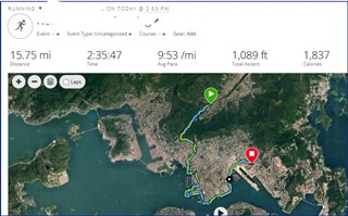

From Garmin Connect Web. Open the erroneous activity then select delete, as in the image below.
Then import the repaired file.
Yes, I can confirm that there is no preivous one.
You posted a screenshot of it. Open that and delete it.
This is the current record. No previous one.
