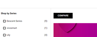

  • There is a great compare function at the Garmin web site. You can compare up to 4 watches. What I usually do is that I take a top watch like Fenix 7 Pro or Forerunner 965 and then compare it with the lower watches to see what functions will be missing if I choose the lower models.

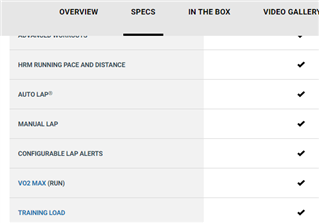

  • Thanks for all your feedback! I was wrong about claiming that Garmin does not have a compare function, thanks for pointing that out. The filter function would have worked real good if you could filter on all the features that are displayed when you compare watches. In my case I wanted to filter on watches having VO2max support, but that is not possible as far as I can see. But I guess I can have overlooked a way of doing that too. Also, Garmin seem to have decided to leave out VO2 cycling as a feature. If you compare Forerunner 245, Forerunner 965 and Fenix 7 f.ex. you only see VO2 max run and VO2 max trail run. But maybe it means they actually do not support measuring VO2 max for cycling anymore? I know they have done it earlier since a colleague with an old Garmin showed me the picture below.
    When it comes to limiting the functionality artificially, that is a quite common in software today, but you normally get the option to unlock the functionality. Just think about all the inn app purchases in Apple store f.ex. Since I was able to download a Garmin IQ app that connected to the power meter on the spinning cycle, it made me think that Garmin easily could have let me unlock that functionality as an add on. Of course I don't know the details of the Garmin hardware and how the different firmware for the watches is handled, so it is maybe impossible for the Forerunner 245 to provide VO2 max for cycling. But if they at least had made it easier for me to understand that I would not get that functionality when I bought the watch, it would have been easier for me to accept.
    So, the bottom line for me I guess, is that they should improve the filtering possibilities in their web shop, to include all the features they show when comparing the watches, as well as adding VO2 cycling as a feature. Or, alternatively, provide an API so that developers could make custom wizards for selecting the perfect watch. From the network inspector in the web browser I can see that they do seem to have an API, but I am not able to find a documentation for it. Here is an example where you filter watches on solar charing capability: https://www.garmin.com/c/api/getProducts?FILTER_FEATURE_SOLAR_CHARGING=true&categoryKey=10002&locale=en-US&storeCode=US&appName=www-category-pages Maybe it is possible to specify a filter for VO2MAX etc.?

  • If you compare Forerunner 245, Forerunner 965 and Fenix 7 f.ex. you only see VO2 max run and VO2 max trail run.
    VO₂max is automatically available when your watch is compatible with power meters, and you have some. And as I already wrote, you can also get cycling VO₂max from indoor rides on apps like Tacx, Zwift, Rouvy, or TrainerRoad even without any device compatible with power meters.

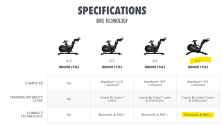

  • Thanks, I’ll keep that in mind, but the spinning bike is an ICG7, which I am pretty sure uses Ant+ to provide the power. And iphone does not support that without a dongle of some sort. I probably will upgrade my watch instead one day…
  • the spinning bike is an ICG7, which I am pretty sure uses Ant+ to provide the power
    The specs tell BT & ANT+:
    However, even if it supported just ANT+, the dongle for a PC or Mac costs 15€.
