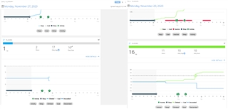

I noticed today that GCW for today's date see's that I climbed 2 flights; Garmin Connect on Apple shows 9 as does my Instinct Solar 2.
While obtaining those flights I was in a walk activity but that has never been in a problem before. How do I fix this on GCW?
I'm signed in with the correct account, the steps are correct. I went up 7 and down 7 during that walk.

  • The app is syncing though, it shows the same steps that are on my watch on GCW. I just did a quick 3 minute walk activity and went up 2 more flights. The up and down graph is not updating.
    I am definitely syncing, when in the app I see the little circle complete around the watch when it goes through the process.
    Here's a screen shot of GCW steps report:

  • I did everything except for checking the crashlog- I'll have to do that when I get home. Watch and app shows 15 up and 10 down, GCW shows: homepage dash (widgets) 15 flights, but daily report shows 4 up and 5 down.
  • If the 4/5 floors were done after the removing/adding the watch, then it looks like it was fixed. As I wrote, the lost data are not guaranteed to reappear with this operation.
  • Hopefully the crash logs will reveal something. It's too bad that the watch can't override what is online. Thank you for the advise so far.
