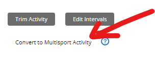

    You can split it into a multisport activity. They will be separate activities but all under the same multisport "umbrella" activity and it will be hard to compare them as they will be listed inside the multisport activity.
  • As wrote, convert the activity to multisport. If you do not know how, click the Edit icon (pencil at top right), and then scroll down:

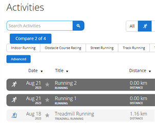

    You do not need to save the individual legs of the multisport activity separately in order to compare them. You can compare them directly in Garmin Connect. Open the main Activities page, select the sport in order to have each leg listed separately, then select the legs you want to compare (up to 4), and click the Compare button at the top.
