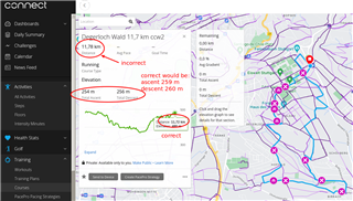

Immediately after just clicking reverse direction, the distance shown increased from e.g. 11.7 km to more than 20 km. Also, the total ascent and decent more than doubles (from 260 m to 530 m in my example).
In another example, the distance increased from 12.5 to 18.2 km, while the total ascent and descent did not change (see screenshot below).

Update: Seems the bug only shows up when I keep the selection at its default "popularity routing". When I select "Freehand" before reversing the route, the problem does not show up. Note that I planned the original course in Freehand mode.
Update 2: For my 11.7 km course, the problem ALSO shows up when reversing in "Freehand" mode. So there is noting that I can do as a workaround! Really bad. Here the "before/after reversing" situation:
I did the duplication and reversing another time (again after selecting "Freehand" before) - this time with another wrong result ("better", but still very wrong):
Update 3: I found that the bug is already present after the duplication: IF I just take the duplicated course and change just one tiny part of the course in Freehand mode, like moving the route by "1 millimeter" at one point, the course distance jumps directly from 11.7 km to 20.7 km and the total ascent / descent changes from 260 to 530 meters, and the elevation diagram start to look very noisy. Something is completely messed up with this tool! Please fix it!

This "almost" works. Also here the course changes its length, but only slightly from 11.72 to 11.78 km, and still with the inconsistency that the total distance (11.78 km) does not agree with the elevation diagram (correct 11.72 km). And again the total ascent/descent change without reason - this time it becomes 4 to 5 meters LESS:

    I just tried with one gpx track of which I made the screenshot above, to reproduce it with the following steps:
    1.) Import the gpx track and select Course Type = "Running".
    --> It shows as having 11.72 km and ascent 255 m and descent 252 m.
    2.) Click "Freehand", and then "Reverse Direction". Wait about 10-15 seconds (it takes some time until the ascent/descent changes).
    --> It shows as having 11.78 km and ascent 228 m and descent 230 m.
    3.) Click "Reverse Direction" again. Wait about 10-15 seconds.
    --> It shows as having 11.78 km and ascent 255 m and descent 253 m.
    I click "Discard" and repeat step 1 above again, new, and this time I get a different result:
    --> It shows as having 11.72 km and ascent 230 m and descent 227 m.
    2.) Click "Freehand", and then "Reverse Direction". Wait about 10-15 seconds.
    --> It shows as having 11.78 km and ascent 254 m and descent 256 m.
    and it goes on like this. Absolutely crazy!
    I do not see the distance increasing more that 0.06 km in the latest example.  Can you reproduce that % increase again using another course?
    Yes, that's what I can reproduce all the time. 60 meters from just reversing the track is definitely a bug already and may point to the root cause of the much greater deviations that I also achieved, as described in my original post. By just reversing the course the difference should be very precisely 0.0 meters.
    And as I said under "update 4" in my original post: The elevation diagram still shows 10.72 km and is thus inconsistent with the displayed total distance of 10.78 km, so there's something fundamentally wrong. Also, when I export and re-import the track, I get 10.72 km again (and also different ascent/descent values). So I propose to remove the root cause of that bug first, and then maybe the other problem with the sometimes much bigger deviation is also fixed.
